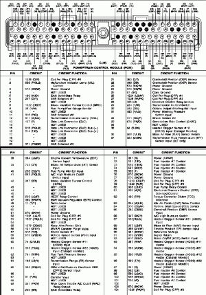

can anyone give me the pin out of the pcm everytime i try to look passed the first page my computer freezes..
thanks!
