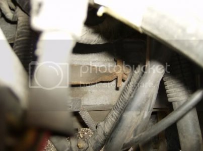

Well, if it helps, check out these pictures of a properly working clutch fork.
engaged
Clutchfork1
Disengaged
Clutchfork2
Now, you mentioned that when you looked at it it looked like about 1-1.5 inches of travel...that sounds about right according to these pics.
Now, what would happen if the quill sleeve was moving with the TOB?
