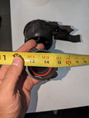

It's just that, a noisemaker. As air passes through it, it's supposed to make your car sound more throaty. I'd definitely recommend removing it as it presents an opportunity for air to leak.
That aftermarket pipe should be fine if you want to spend the cash. Or, for about $10 just fill the hole with a Dorman plug. Check my old posts. Somewhere a long time ago, I posted the Dorman part #. I've been using it for years with no issues.
I happened to be close to the factory part in the shop when I noticed this post. Here's the hole size you need to fill when you remove it.5d1759a89040bdba88537c159dc645f6

Yea I’m going to see if they have this part at my ace hardware https://shoforum.com/threads/noise-maker-elimination.132044/
206a54410025a427bdbb29c6ae7935a5
Just to be 100 percent positive I’m just popping this off and capping it?
Joshw0000
Sep 20, 2018
777
595
North Carolina
Yep. Wipe the inside of the hole clean and maybe gently scuff the outside of the Dorman so they adhere together. Pop it in and tighten the plug.
