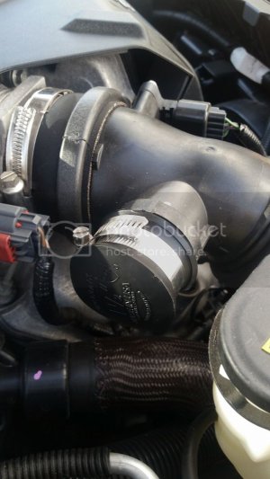

I looked all over. I was hoping someone had figured a way to plug the opening. I couldn't find anything. At this time I don't want to buy the MKS / Flex part. I didn't want an after-market pipe either. I come up with something similar to the chair leg cap for the BOV- VTA mod. I used a 1-1/2" sewer pipe cap. It's rubber and came with the clamp from Ace hardware for $3.99
Besides the Ace numbers, the part is stamped Pipeconx 1-1/2 plastic or cast iron. It also says made in USA, Evansville Indian so it's gotta work!
20160415 101807 zpsofnwtes5
20160415 095617 zps4gkoeeue
I was worried about it holding up to boost preasure. Tested it and got some peak boost at 16lbs with no problems. I was also worried about creating strange airflow dynamics. The air flow may have changed I don't know but performance is same as it ever was. I did notice it was much more quiet inside the cabin which is what I was trying to accomplish. I like the results. I was never fond of the idea of making fake engine noise. It also frees up a little space in engine bay. I'm interested in how it holds up in time with under hood heat. I have the noise maker and screwdriver in the trunk in case this pipe cap blows out.

Well pulled the noise maker off and put that rubber cap on. My 16 is about 1" OD and the inside of the cap is 1- 1/2" but the clamp snugged it up. Still think I'll try to find a cap with a 1" ID..Uploadfromtaptalk1464565513566

Well pulled the noise maker off and put that rubber cap on. My 16 is about 1" OD and the inside of the cap is 1- 1/2" but the clamp snugged it up. Still think I'll try to find a cap with a 1" ID..View attachment 2544
Sent from my DROID RAZR HD using Tapatalk
I looked for 1" and 1-1/4" at Ace. They just didn't have it and this one worked.

I used a Dremel to trim the narrow end of the outlet off, then the cap fits perfectly and has a lip to seal on.
