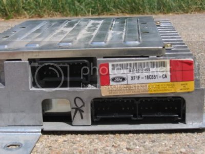

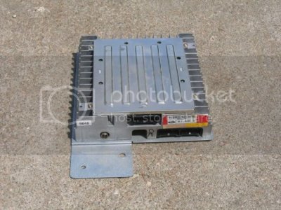

It connects into the amplifier which is on the drivers side wheelwell underneath the trunk carpet. So my guess is that you need to either push it into the antenna or amp depending on which end got pulled loose.
Amp connections
TaurusAmpclose
TaurusAmp

i know where it connects to the amp, I cant find where the other end connects..I can move the plug around and get stations, but once I set it down I lose the station. it has to connest somewhere by the power antenna, i just have no idea where..
naval-avi8or
Mar 1, 2002
1,597
24
Chesapeake, VA
I was just looking at the manual and it shows it pluging in the mast just below the body thru fitting on the side towards the rear of the car. The connector comes out of the mast and has a 90 deg bend downwards.
