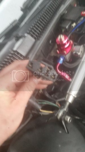

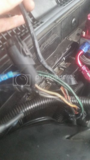

not entirely sure yet is there a plug for a handheld scanner? I found big plug for self test but the grey plug was not with it and I couldn't find it unless im blind and I followed harness for test plug to where it meets the thick harness and there were no wires cut or anything I have to take it back to his house still to figure that part out he might have hidden it in the harness and just cant remember

Yes I found the 6? Pin plug ********* one but not sti jumper

On my 90, the little gray plug has exactly the same length of wire as the larger, odd shaped plug. Both fit in a plastic end cover that says "EEC Test".
The little gray plug comes out of the corrugated protective plastic sheath that the large plug wires emerge from in the wiring harness.
Cut back that sheathing and see if there is a broken wire in there; and look for that "EEC Test" plastic cover, either on the firewall or loose in the area you are concerned with, in the hopes the wire / connector is still in it.
What year is you car / harness.
Here is some help on the paper clip method:

this is what ive found so far car is a 91 he said he didn't think so but is it possible he put it into the big bulkhead? how many wires are suppose to feed into big one I have 6

My car has no where near that length of wire on the connectors. It looks like the wires were extended so the person could see the code reader while he was sitting in the drivers seat. Unwrap all that electrical tape back to where the wires emerge from the corrugated conduit that jackets the wiring harness. Then be prepared to cut back the corrugated jacket to look for the mystery wire and connector. My car has no wires covered by electrical tape, all that has been added to extend those connectors.

Take a look at the link in post 8. That is a typical wiring set up in the first picture. And it looks like you need that small wire to get the codes, and probably the code reader needs it too.

Ok will check voltage there I found the sti wire it was in fact in ********* plug koeo I got a code 85 and there were some stored I kept getting confused counting but I think one was pip I have since cleared codes and haven't been able to **** the car as of yet today koer I got a air charge one time and a knock sensor but ran again came up with 11s multiple times
