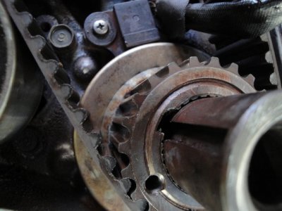

Another thing to watch out for is crank cancer, where the slot for the woodruff key in the timing pulley on the crank has opened up and smashed the key out of place. This could cause the crank to spin, but not the timing belt pulley, or it might intermittently.
Like this:
Dsc00731
Unfortunately, the only way to find out for sure is to pull the crank pulley off.
