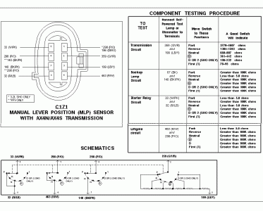

If the power antenna works then the key switch is good as it is on the same circuit as the starter solenoid.
The power goes from the ignition switch through the MLP on the tranny to the solenoid.
When cranking with the test light see if there is 12V on the Red and light Blue wire at the MLP or the DIS.
