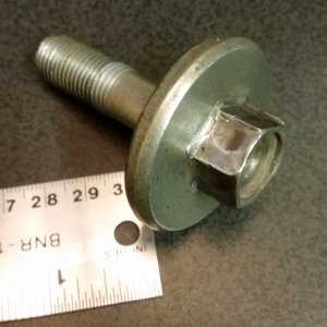

Look what I have that SHOSource does not - and apparently no Ford, NAPA, Autozone, Oreilly, RockAuto, eBay, or anywhere else in the world...
Fortunately, not my only backup, so I can part with it.
There is one more to be found, in a box in my garage in Colorado. Got out of the SHO game in 2017 but still have boxes of parts. WHY? smh
