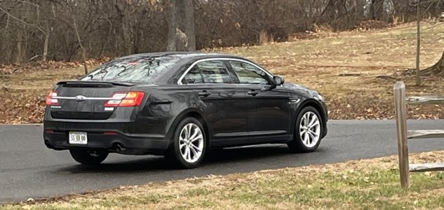

"Bye bye baby, baby goodbye.
Bye bye baby, don't make me cry..."
-- Bay City Rollers
IMG 1147
