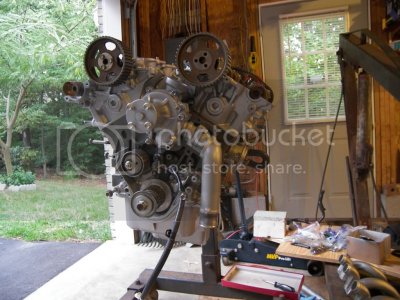

OK engine is out and it actually looks pretty good upon first inspection. Most of the seals look to be leaking at least a little but no gushers. I havent even drained the oil yet, but its on the stand and ready for a clean garage.
Frontal

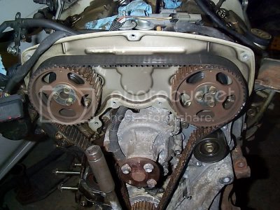

I have the timing covers off and it looks like they used a 3.0 timing belt from the factory. I cannot seem to get the marks on the belt to line up with the dots on the sprockets.
Timingmarks

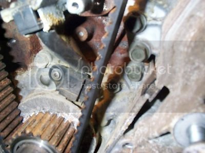

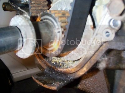

And heres what a leaking water pump will do...see all that green and white stuff that has collected below the belt and is sticking to the vanes on the CPS? That's corrosion from the water pump leaking and getting it all wet in there.
CPScalcium
Timinggear
Here's a tip: If you pull off the upper timing cover and the belt has rust on the teeth, you've got a bad water pump.

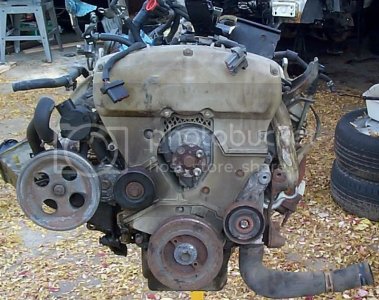

Well I have taken off the timing belt, sprockets, and rear timing cover. It looks like I will be needing cam seals. The crank looks great but the waterpump housing confuses me. It's a LOT different than the 3.0. Anyone got a picture of a 3.0 waterpump and housing?
Edit, Pics to follow when I get batteries.

The best pic I have of the water pump is of it assembled and installed to the block and heads. It's the same picture I showed you on your thread asking for pics of 3.0 with no timing covers.
100 1648

Can I steal that photo? I wanna resize and repost it side by side with the 3.0
OK so waterpumps are diff too? not just the housing?

Yeah man, do whatever you want with that photo. But you are correct, both the housing and pump itself are different on the 3.0.
