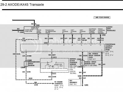

Ok, I was trying to figure out why my car has a harsh 1 2 shift and why the transmission just lets go when I floor it. Turns out someone has getto rigged all the wires on the transmission connector! It looks like they put the wires into the wrong pins. Does anyone have a picture of there connector (white connector on transmission, right below intake hose)? Or even a wiring diagram showing which wires go to what pins? :thankyou: BTW I checked all the wires from the pcm to the connector and they all had good resistance.

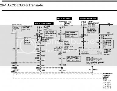

Don't forget page 29-3 with the connector on it:

Thanks guys! From looking at it I can already tell the SS1 is not even connected and the EPC is going to the TCC! I don't know why anyone would do this? I'm just helping the wiring actually going to all the seleniods is correct.
