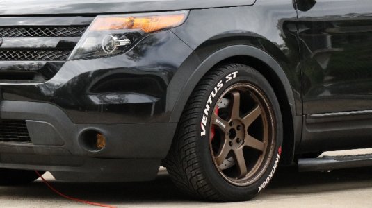

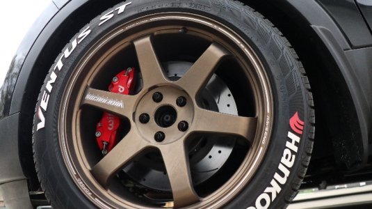

All,
For those interested I could provide the high strength steel CNC machined adapter brackets and mounting hardware so that the 2013+ SHO's could utilize the following Wilwood Super-Light 4 Big Brake Kit which would work in conjunction with the OEM sized 2013+ 14" front rotors. These brackets would be very similar to the ones i designed and manufactured for Lee with the Wilwood Aero6 calipers. This front brake solution would save approximately 10 lbs per corner over stock front brakes. This kit would utilize the following parts which are listed below that can be purchased directly from Summit Racing online. These brackets would imply bolt onto the existing front knuckle and would require zero cutting or fabrication of any kind. It would be a true bolt on solution and could be easily reversed if the owner wanted to revert back to the stock front brakes.
Benefits of this front brake kit include:
  • Weight saving of approximately 10 lbs per corner (20lbs total for the front brakes) over the OEM front brake calipers and brackets
  • Ability to utilize Wilwood's high quality and easy change brake pads & compounds, BP10 & BP20
  • Ability to utilize front stainless braided brake lines which when compared to OEM rubber lines should provide more protection from lines swelling
  • Ability to utilize a 4 piston caliper instead of the OEM 2 piston which allows for a more equality distributed clamping force
  • Aesthetically the front brakes now have the big brake look that a lot of car enthusiasts prefer
SEP adapter brackets & hardware: $600
Wilwood components required: $626
Total: $1226

Ok i have a few questions and then I would like an invoice or something to pay for the brackets.
1. I want to go with the caliper that has the 5.18 piston area. Will that cause any problems? Like maybe pedal problems?
2. My 2011 has the exact same knuckle as the 2013+? Right?
3.If I wanted a bracket for the Aero4 calipers, is that available?
4.Are the aero calipers (noticeably) better?
5.do you have any brackets for the rear? I'm considering just putting the 2013+ brakes on the rear.
6. Are there any 2 piece 14" rotors that will work with these brackets?
Matthew thank you for interest,
I accept PayPal and my username is [email protected]. The cost of the Superlight 4 or Aero6 adapter bracket kit for the Taurus SHO with mounting hardware is $600, shipping for this kit being $25, potentially less on shipping if i can find an adequately sized flat rate box. $625 would be the total order amount. My machine shop vendor usually can get the order manufactured in 3-4 weeks depending on their production lead time. I can check with him once you decide to move forward and can then get a more precise lead time.
1a. Use the Superlight 4 with the 4.84 piston area or the Aero6 with the 5.40 piston area. This size is specified as it needs to match as close as possible to the stock piston area or the awd, traction control, ABS will go nuts and will cause performance and safety issues and concerns.
1b. Lee has successfully used the Aero6 with the 5.40 piston area which is what I calculated would be the best fit for the Taurus SHO and his car operates flawlessly.
2. The knuckles of the 2010-12 should be the same as the 2013 as the oem rotors and calipers are interchangeable. This brake kit is designed around using the 2013+ rotor so that will be required and it is reqomended to use the 2013+ master cylinder as well.
3. Unfortunately no, I only have designed brake kits for the Aero6 and the Super-Light 4 calipers. The Aero6 is the cream of the crop so to speak but the overall kit cost doesn't seem financially justifiable and no one other than Lee purchased a kit. The Superlight 4 is the best bang for the buck and also is a weight savings over stock which is why i chose that caliper to use in the kit I designed.
4. Both the Aero6 and the Superlight4 are great high quality calipers. I personally would go with the Superlight 4 due to the weight savings and they are more affordable than the Aero6.
5. No, It is not cost effective to modify the rear brakes, just use PP pads on oem 2013+ rear caliper and rotors. The front brakes do 70% of the brake work anyways so modifying the front is all that is necessary. Also modifying the rear brakes would require removal of the parking brake which a safety concern.
6. The 2013+ Taurus SHO OEM one piece front rotors are 14". They are cost effective and aftermarket rotors for the 2013+ SHO can be had in drilled and slotted configurations. The 14" 2 piece rotor is very expensive and will prevent the kit from being marketable so I have not pursued that.
