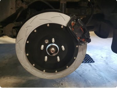

Wilwood kit saves a nice amount of weight. Remember, the rotors are 2-piece design, with the hats being billet aluminum.
Front Rotor Comparison:
y4m7fgzxEALRIdUlWJbA5YR6mk6KH11iy4IRoa2C9f3KvocPfoUAeIdiw7FbjfbhNydTwEdsiN7X66d_n5-YB7yB62_PRUv44oUvAg9fHgKgF1SXsBHQs2sMo6YWIqVhbubV_jReFfI5_26g15IbhFqk_NfhGLn9NTTFLHSpWjTvXdgfUobKTaGfhFvR9FZFKGYYGCp6unfI6LyXeEjfKL6Ew
Front Caliper Comparison:
y4mUChUztc_cpDCZYe_Wsx0GZn_ladHihK0HTKLrER5iwhYw_85rK5CHV71JXJuu6I6MYAADycW4h1v0A66XR95KzApe11nsTKuKHDUaxcFozMDJ5qdxv1KaVvEMUsTRlVHh86UxLM-fbl0WDO7J4MeGaseac8KCNGWM-ftwGCEG6zfKAmGit7C-SLa0oyIXfoqQCM4Zg4c474nDHOMXktrdw
Front Pad Comparison:
y4mgnFTl--75PspXWAMrHzG-0BUyKxt9cIQNKBpRO2s8ACLhtDxGyfjDg9i3J0q1Meaeo59uz8jGPC3FcFP3BEaCzoC-vkyB4k8_ngC9tarPwC-b4-LacrWv7cfjBxiD9THNRwNf18D-Ibdk8UeOvjTLQJ33UMQT167avIo0dkK-tsuhmP7bRc09vEc0CiXYGOM7YAqvK5DrrztPYAReC3raA
Saved about 16.5lbs per corner in the front (about 33lbs total up front)
Rear Rotor Comparison:
y4mN0weJUB4HUKV-6Kjk2dj2vK8ijgy4a989lj6VcC79XoeBo-JIhocZ4nfSpH9UlQaZzxFrpEft-7ligqP97dlnUsf96Tfkcd18alZQLWKravIuiPbwOnNQi1jptB_L8E-jOWiaa3AKLjBq1eZDA10N9K3TIwNL_dcncHUbxO2ClvsTfwT40scOUOdFfni1IlnythHcyItKXTg1M5dOigSrA
Rear Caliper Comparison:
y4mvAuRni39wg_jVTrauyFV2aidNXBFPs7LGPv_Lps_xnW1l6RNZ9XNaFjpT0dbA0OWyGMkfe1g7wk_LoG5N5N8RMA2prm11-v_myEl6dWqNWsszG_ZhoyKpZvPEdHfz01oh_rn8TUQoXTJ2AwOGBObeNIveQVIOSuVHTFpAXy9cvDrSTFe3JVCdbwlq6r2dJee0RwrLbPPWumo_8vQtkt2aw
Rear Pad Comparison:
y4m80F40GMsTUB1WO877v5S_NumBbjGCmr73LKO9Ed3ZB8pJxgvT02ywogogCe00M5oiYEUb5dDQTeTuART_bgcWQYAzK7J5W6Z8uYQkwboOQL0h_DKczQYWSBGDQDLYKdqj4oT17yyZ9bd5lEMCq6M15DImHzv-69s3GEbqfqDulZ_ISC79aVNksg4z8qp2gisloOtqzirxlSEqJMtFBC_qg
The rear came up to about a wash...
But considering everything is bigger, I'd say it's a win...

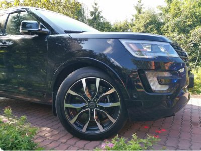

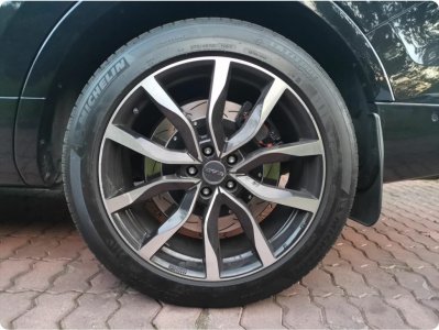

What's interesting is, I was chatting with some guy overseas on IG that managed to fit BMW X5M 16" rotors on his XSport (at least that's where he said he sourced them). And used the Brembos off it. The XSport and the SHO share the same rotors, btw. I saw the pic, but who knows...lol. Let me see if I can find that photo...
EDIT: Found em...I don't have many details on how they got it to work.
Nt6IcjjWbxZk5Qwidth1024height768cropmodenone
7RKdORjiKFkIxAwidth1024height771cropmodenone
DOepUcsa9l889Qwidth1024height767cropmodenone

No, I meant the SHO has the same rotors as the XSport, not the BMW...which tells me if somebody got them to fit on an XSport..it MAY fit on a SHO...
I probably need to go retype that because I can see how it looks like I meant that...
