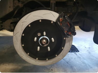

What's interesting is, I was chatting with some guy overseas on IG that managed to fit BMW X5M 16" rotors on his XSport (at least that's where he said he sourced them). And used the Brembos off it. The XSport and the SHO share the same rotors, btw. I saw the pic, but who knows...lol. Let me see if I can find that photo...
EDIT: Found em...I don't have many details on how they got it to work.
Nt6IcjjWbxZk5Qwidth1024height768cropmodenone
7RKdORjiKFkIxAwidth1024height771cropmodenone
DOepUcsa9l889Qwidth1024height767cropmodenone

Honestly, he was a guy in Russia and our conversation was very broken since whatever translation algorithm IG uses didn't help much...I can pass his IG name on here to anyone we who wants to reach out to him...

Wilwood kit saves a nice amount of weight. Remember, the rotors are 2-piece design, with the hats being billet aluminum.
Front Rotor Comparison:
y4m7fgzxEALRIdUlWJbA5YR6mk6KH11iy4IRoa2C9f3KvocPfoUAeIdiw7FbjfbhNydTwEdsiN7X66d_n5-YB7yB62_PRUv44oUvAg9fHgKgF1SXsBHQs2sMo6YWIqVhbubV_jReFfI5_26g15IbhFqk_NfhGLn9NTTFLHSpWjTvXdgfUobKTaGfhFvR9FZFKGYYGCp6unfI6LyXeEjfKL6Ew
Front Caliper Comparison:
y4mUChUztc_cpDCZYe_Wsx0GZn_ladHihK0HTKLrER5iwhYw_85rK5CHV71JXJuu6I6MYAADycW4h1v0A66XR95KzApe11nsTKuKHDUaxcFozMDJ5qdxv1KaVvEMUsTRlVHh86UxLM-fbl0WDO7J4MeGaseac8KCNGWM-ftwGCEG6zfKAmGit7C-SLa0oyIXfoqQCM4Zg4c474nDHOMXktrdw
Front Pad Comparison:
y4mgnFTl--75PspXWAMrHzG-0BUyKxt9cIQNKBpRO2s8ACLhtDxGyfjDg9i3J0q1Meaeo59uz8jGPC3FcFP3BEaCzoC-vkyB4k8_ngC9tarPwC-b4-LacrWv7cfjBxiD9THNRwNf18D-Ibdk8UeOvjTLQJ33UMQT167avIo0dkK-tsuhmP7bRc09vEc0CiXYGOM7YAqvK5DrrztPYAReC3raA
Saved about 16.5lbs per corner in the front (about 33lbs total up front)
Rear Rotor Comparison:
y4mN0weJUB4HUKV-6Kjk2dj2vK8ijgy4a989lj6VcC79XoeBo-JIhocZ4nfSpH9UlQaZzxFrpEft-7ligqP97dlnUsf96Tfkcd18alZQLWKravIuiPbwOnNQi1jptB_L8E-jOWiaa3AKLjBq1eZDA10N9K3TIwNL_dcncHUbxO2ClvsTfwT40scOUOdFfni1IlnythHcyItKXTg1M5dOigSrA
Rear Caliper Comparison:
y4mvAuRni39wg_jVTrauyFV2aidNXBFPs7LGPv_Lps_xnW1l6RNZ9XNaFjpT0dbA0OWyGMkfe1g7wk_LoG5N5N8RMA2prm11-v_myEl6dWqNWsszG_ZhoyKpZvPEdHfz01oh_rn8TUQoXTJ2AwOGBObeNIveQVIOSuVHTFpAXy9cvDrSTFe3JVCdbwlq6r2dJee0RwrLbPPWumo_8vQtkt2aw
Rear Pad Comparison:
y4m80F40GMsTUB1WO877v5S_NumBbjGCmr73LKO9Ed3ZB8pJxgvT02ywogogCe00M5oiYEUb5dDQTeTuART_bgcWQYAzK7J5W6Z8uYQkwboOQL0h_DKczQYWSBGDQDLYKdqj4oT17yyZ9bd5lEMCq6M15DImHzv-69s3GEbqfqDulZ_ISC79aVNksg4z8qp2gisloOtqzirxlSEqJMtFBC_qg
The rear came up to about a wash...
But considering everything is bigger, I'd say it's a win...[/QUOTE

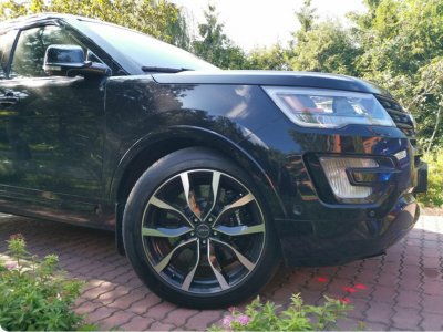

For the record my rims are not bronze.
Oh shit, lol. I've seen this pic a couple times, always thought to myself...I'm not really feeling that matte bronze look...
Kevin81
Apr 9, 2020
666
540
USA
What’s funny, I saw that and thought, I kinda like that matte bronze.
And there you go! All he needs to do is hit it with some spray adhesive, and voila! Matte bronze wheels.
Haha, it is kinda nice to see what if would look like.
It has kinda grown on me honestly.
Pssshhhhhhh....I would just clear it as it sits! YOLO!
