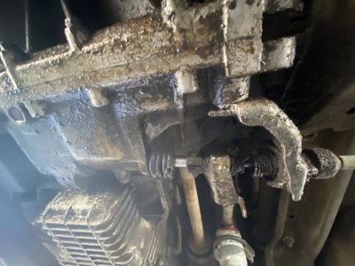

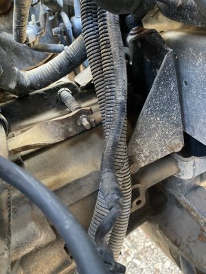

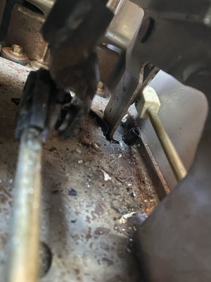

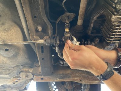

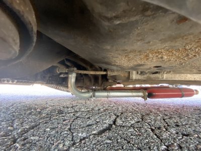

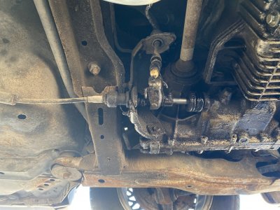

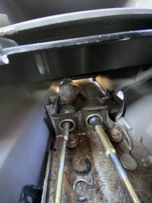

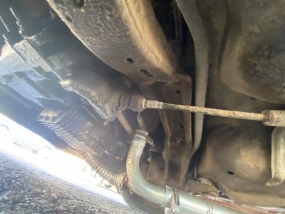

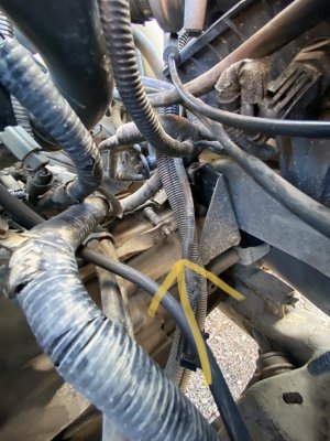

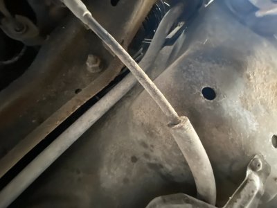

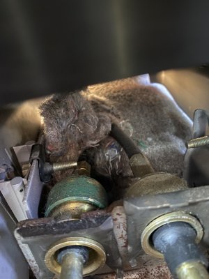

I was unable to locate anything you guys suggested that I inspect bedides a single cable leading to the Transmission which has an orange arrow pointing towards it. Can you all help direct me with help from the pictures?

You have the cable shifter, not rod. I can't tell from the pictures what is disconnected. If you cant see under inspection, ask a freind to work the shifter while you watch for what is disconnected. SHO Source sells repair parts. The first 5 pictures are of the clutch cable.

Aaaaah my mistake. So the rod linkages are not referring to the pistons in the actual shifter column. That’s partially a relief, since from I could tell rod swaps are in repairable due to discontinuation. I will get out there at today and have someone shake the shifter and inspect.

So, judging from your pics, you've taken a look at the two cables where they attach to the gear shift lever and found that they are both still attached. Now look at the transmission end of the cables. Inspect the horizontal cable where it attaches to the gear selector shaft. The end of the cable is a plastic square with a bushing in the middle. I think you will find that the plastic bushing is missing. If so:

Turns out a ball joint of some sort popped off on the underside. We just went crazy with bailing wire.
