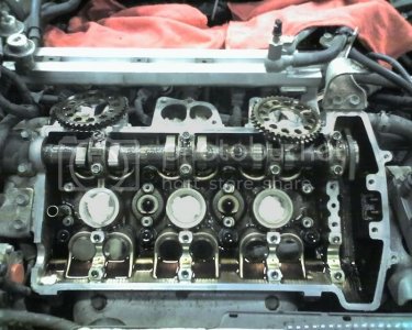

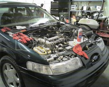

Heres my car sitting in the shop i work in. Luckily its heated so i get to do this inside away from the cold!

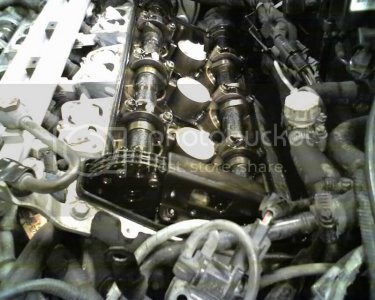

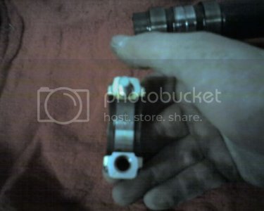

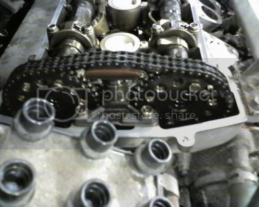

Well.. I got away with just having to remove the exhaust cam on the front and was easily able to get the tensioner and chain off.
Dec08 0003
However i found somthing i really didnt want to see. The cam bearing closest to the front of the motor looks bad like it was starved for oil at one point. I tried to get some pictures but my phone camera wasnt able to get a clear enough shot to really see the damage.
Dec08 0015

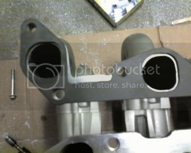

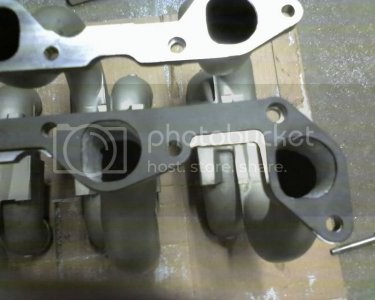

Ported The Intake
Well while waiting for the tools to do the valve lash i decided to port my intake:
Before
Dec11 0002
After

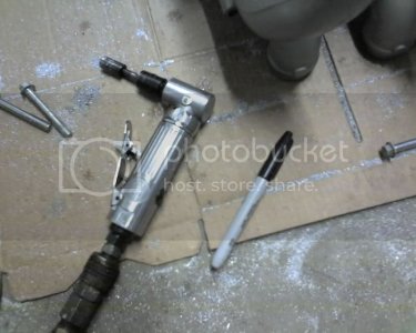

And the tools
Dec11 0003
Next are the heads which im having reservations about doing. I think im going to do the playdoh trick and have a vacume next to the die grinder to keep as little metal from droping into the intake port as possible.

Finished gasket matching/porting the tanks and installed the exhaust cam with the good news that none of the bolts striped (whew!) I did the first stage at 95in lbs then 12ft lbs on the second. Got the new timing chain in the front while asembling everything along with the tensioner after rebuilding it. Tomarrow is the rear timing chain and the nerve racking porting of the heads. I have the feeling im going to have a hard time keeping my hands still while doing this one!

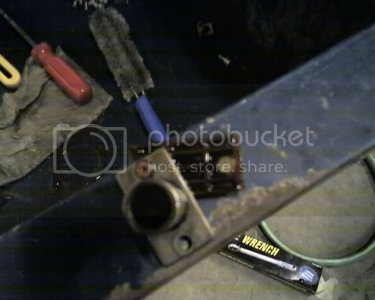

Well got to taking the rear timing chain tensioner off and.....
Dec13 0001
Whats the big deal right? Well this one does tricks!
Dec13 0002
