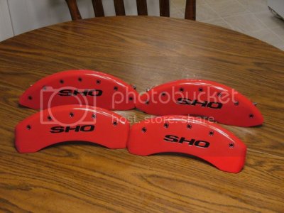

joe- i've had mine a good 15 months, have not noticed any issue with brake heat, but have noted reduced brake dust. i see your sho is white, i got red ones as well but had them do the sho in black as standard was gray. cost more but i liked with my color schemeShocalipher zpsemiiz0cb

maybe because mine was a '10, but i don't think it was an issue. i had the shop i go to do them as was changing the rotors & pads at the same time. mgp included some 1/4" spacers & didn't have to use them. but my guy was worried about them staying on, so without asking me tapped them to caliphers. luckily was able to match the red color with some touchup paint & painted the heads of the screws, so turned out not to be a big deal.

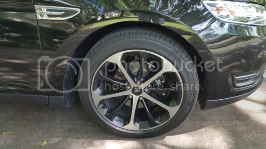

I followed their advise and raised the front calipers and they fit perfectly.
I bought my car June 1 and have had the caliper covers since the second week I owned the car.

My car is a 2015 SEL with the optional 20" wheels and MGP advised me to also use the spacers which they sent me free of charge. I would post a picture of them mounted if I figure out how.
