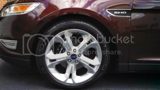

Hello, I am sorry to have to ask this but I have searched for hours and im getting different answers. I just purchased powerstop rotors and EBC pads. I also bought the MGP caliper covers. I was wondering since I have the factory 20" wheels do I need to get spacers? If so I have never bought spacers so I don't know where or how to get them. Any help would be appreciated thank you

i think if your car needed them mgp would have sent them. they did with my '10 non-pp. some of the 10's w/19" wheels did need them if a certain tsb had been done with the wheels. mine didn't need them. the spacer was only 1/8" or 1/4" & had to do with the offset of the 19" wheels. never heard of issue with 20". it you need them get the smallest possible. i think i'd call mgp direct & they should know.

good post. I am about to pull the trigger on these too. have a 2010 non PP with 20s.

mgp direct as wanted custom. forgot $$ but was a up charge for non-standard. mine are red with black sho letters. red normal letters were gray but didn't match my color scheme.

That seems pricey for some (assuming) plastic covers. Do they last? How are they attached? I would be terrified that they would pop off if I hit a pothole.

got mine in the mail...aluminum...waiting for the spacers, cause they forgot. Went with black with silver SHO.
Hopefully there not too much of a PITA to install. Just trying to find time now.

Put them on and clips are dragging on top of rotors. Cover fit OK and seem secure enough. What about the clips though? 2\4 have contact and they are the rear.

The instructions recommend putting a standard business card thickness in between the rotor and clips to check for clearance. Mine just show shipped last Friday but will report when installed.

Might be too tight. Send photos when able did you try loosening the clip and maybe put a washer under the nut see if that helps?
