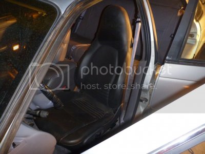

P1000595
It would be Recaros, but it took all day Sunday to make the 4 brackets to mount just the driver side. I haven't even touched on the wiring yet.
And you would think seats that came out of a 911 would be light, but I'd bet these are within pounds (kilos?) of the factory seats. Since this is a 3 day weekend (thank you Ceasar Chavez) I'll attack the passenger seat, power wiring and heater controls after a quick CV axle swap.

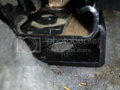

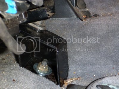

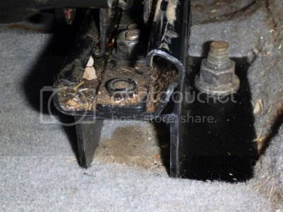

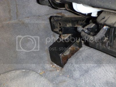

I wasn't super happy with all of my mounts. They work, but they were a lot of work to build. Since these are electric power Porsche 911 Recaros, I didn't even look around for brackets.
For the front two, I cut down some 2 inch square tube at an angle to match the floorboard, cut one side of the tube off to turn it into C channel and then capped it. Inside was about 1" tall, outside was 1.5 or 2. For the rear, the outside mount was just a 4 inch piece of 1X2 rectangle with holes drilled in the right place. The inside mount was two pieces of 1.5 inch angle welded together. That's the one I'm least happy with as that is the seatbelt mount side, so I'm not convinced of its strength. I may pick up some 1.5 inch square tube and redo it.
Front inner
P1000588
Front outer
P1000591
Rear outer
P1000593
Rear inner
P1000592
The Porsche sliders are half an inch wider than the SHO and substantially longer. Don't even think about this unless you own several ratchety wrenches and a fair amount of patience.
