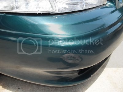

Got in a Fender Bender Sunday night. Really messed up the front bumper Cover and I destroyed he bumper under it. Decided it would be a good chance to practice my painting skill. I have to say, This came out really good for What it was. Looks Good enough to do the whole car in it imo. We'll see how the bumper looks in a couple of weeks. :sun:
DSCF5131
Remember, the bumper had this sratch in the plastic.

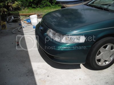

DSCF5109
I understand this isnt an exact match, it's the best I could do for whatever aftermarket paint they used. But how did it come out? Good enough for paint a car? I do plan on waxing in a couple of days after the paint hardens a little more.

At eighty cents an ounce, I would not paint the whole car with Dupli-Color Perfect Match. It's decent looking paint for a rattle can, but it'll end up more expensive than you might be thinking.

When you get it repainted if you ever do, they will have to strip all that spray paint off the car before they paint it. Where as they would have just ruffed it up then sprayed it.

because spray paint is garbage really. all of it is duplicolor, rustoleum, whatever brand name you can think off its all garbage when compared to any paint that needs to be mixed with catalyzers and reducers and then sprayed from specialized equipment.
do a real paint job over a spray paint job and it will never hold up. either the spray paint will curdle before the job is dry, or it will start blowing off the car as soon as it starts to rock chip.
and i really do mean blowing off the car, it can come off in sheets due to air pressure
at the dealer, the most we would ever rattle can was mirrors or small trim bits. touch up color coat from parts dept, PPG clear coat. But thats different
93rev2sev
Nov 1, 2004
6,461
1,825
Hockeytown
Not only that, but there are technical reasons the rattle can stuff has to come off before getting a real paint job.
Real 2-part paint is pretty harsh. As soon as it comes into contact with the car, it will start to dissolve the duplicolor. At BEST it will make the duplicolor soft, at worst, it will act just like paint stripper and make it wrinkle and lift right off of the substrate.
Rattle can "dries"; it can be made "wet" again by the solvents in the real paint
Real paint "cures" and becomes a protective sheet of plastic; a lot less susceptible to being dissolved.

Keep going, and tidy up the car the best you can for the money you have.
For not knowing what colour was resprayed before you got the car, you did a pretty good job of matching the bumper.
Carry on and keep improving the looks, even if it is a spraycan job. Chances are, you will be the last owner of this SHO, so you will remember where the paint has to come off if you ever win the lottery.
The parts you have fixed, look an awful lot better than they were before.
