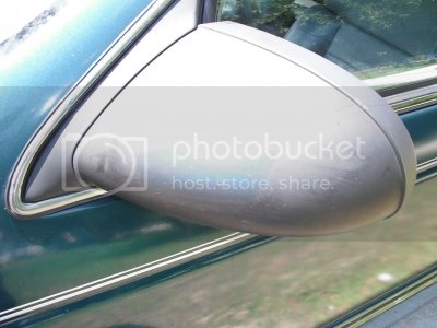

First issue. What chemical can I use to get this paint off the mirrors?
What you see there is how the came....

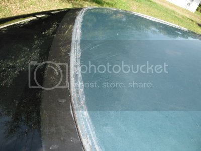

Rear window trim. It's all baked like a potato chip. I've been to a could of glass places and they said the only way I can fix it is to get a new piece of glass since the glass comes already in the gasket.

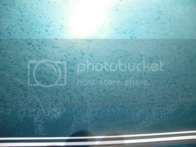

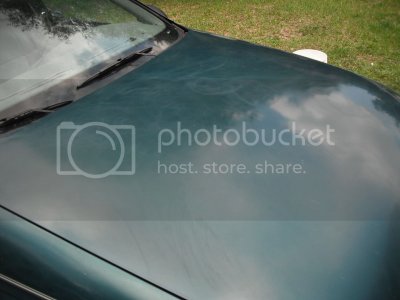

Swirl marks in the hood are so bad I just get mad looking at it. The only time the hood looks good is when its got an even coat of water on it while i wash the car. The passenger side fender has a similar story, it looks like someone tried to wax the hood and fender when some electric tool and brought the old paint up on the fender or something....

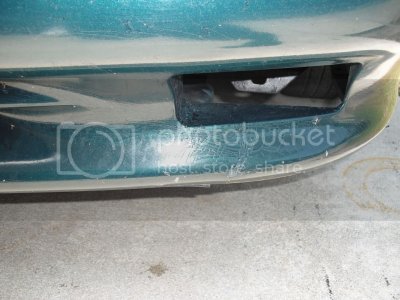

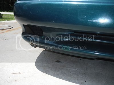

The bumper is pretty torn up from running over parking blocks and has rips in it and spiderweb cracks. With some help im not bad at repairing things with fiberglass so would it be worth it to repair it or just get another?

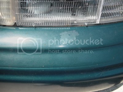

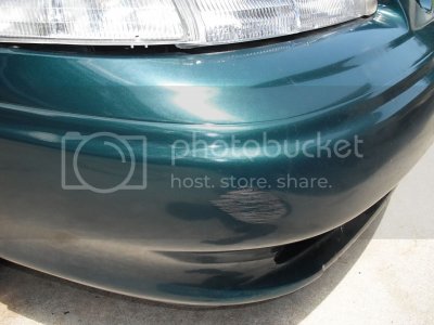

Lastly.... These scuffs from hitting a pole or something like that. They are not just surface scuffs. But they dug into the plastic a little bit. Is there a solution for that?

I hoping that I dont need to have the entire thing repainted... That's way too rich for my blood and even though I dislike the shade they used I have to admit the paint job is alright with the exception of the mirrors getting painted and the front bumper paint peeling.

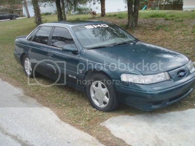

My SHO looks good from far away as long as you dont notice two backwards slicers :p but when it's close up.. Man this crap stands out.
Here is what the car looks like when you keep your distance. Also I think the emerald green it used to have is the same as what they use on expeditions.

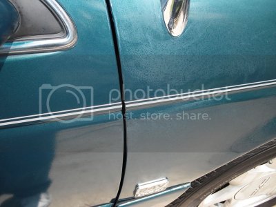

I hear ya about looking like a dick that doesnt take care of their car, mine has some spots i need to tackle as well but i have fender rot so that is going to be harder to fix. However, the first thing i would do before any of that stuff is lose the f'in pinstripe.

lol..looks like my drive way almost.. With the green 97 expedition and the green 94. And with the pinstripe? use a little heat from a heat gun and scrape the pinstripe with a finger nail.. thats what i did. Also.. make sure that pin stripe doesnt have any overspray from paint or clear coat... otherwise it will be a ***** to take off. Since the stripe looks pretty good and intact i wouldnt really bother with it right now. The rust hole you probably could tackle.. but if you really want to get the car to look halfway decent you are probably gonna be looking for a Uspray booth and a buddy who can lay down a good coat of paint. If money is a serious issue i would just go with a single stage.

the hood and fender arent swirlded paint, they are sand scratch markes from the "cut" part of "cut and buff". those can be taken care off by anyone that knows how to properly buff a paint job
fiberglass is the wrong material to repair the bumper, just buy a new one and have it painted because often the spiderweb cracks in pain go INTO the plastic and can show again later.

im pretty sure your right that the rear window trim is only available w/ glass attached

I purchased two used mirrors for my 1994 - One was black and one was red with the paint peeling and black showing through.
I sanded them to a ruff surface and took standard black auto paint and sprayed them down a few times. Flat Black will do and it matches fairly close to the original. As long as you paint both they look good. If you want I can post pictures later today if you wish to see them.

you can sand down the mirrors also!....and then buff it out! Huntervf, did this for Eric Vervalin's car and they turned out pretty good! awsome if I may say so myself!

I dont want to sound harsh , but its a junker. Its way passed his time to be saved.
Theres 3-500$ shos out there 10 times in better shape. Id use this as a DD till it dies. And grab 500$ and look for another one.

Buffing will take that green paint off without sanding?
*100th Post*
its not smeared paint, its just the sanding marks from removing the orange peel in the final paint job.
its REALLY hard to smear paint, and to smear that much area Gozer and Zuul themselves would have to work together to get it done in less then a century
The pattern to the marks is spot on for sanded ("cut") orange peel
