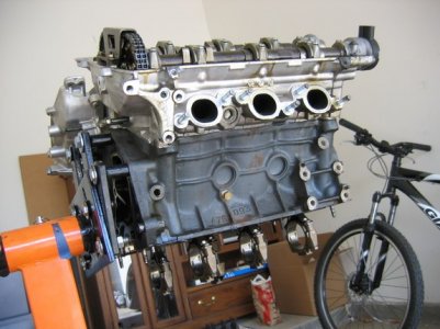

Judging by the extra webbing on the 3.2L blocks, it would be safe to say they are a different cast.
Here is my '95 3L block (castings numbers visable).
26748930034 large
