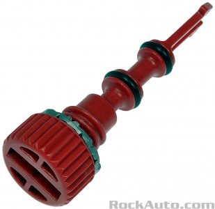

Thank you. I did the drain plug in the PTU mod and need to be certain it isn't leaking, plus I'm trying to find the sweet spot between not tightening the pathetic PLASTIC radiator drain plug such that it leaks and TOO tight such that it breaks. Need to be able to see drips on the paper on the garage floor. Diaper is off for now. Should run a little cooler with summer coming.

The radiator drain plug seals with an O-ring in a bore. The O-ring doesn't tighten against anything. Just tighten until it stops. If it leaks, replace it.
1713894169489
Or this
1713894268750
