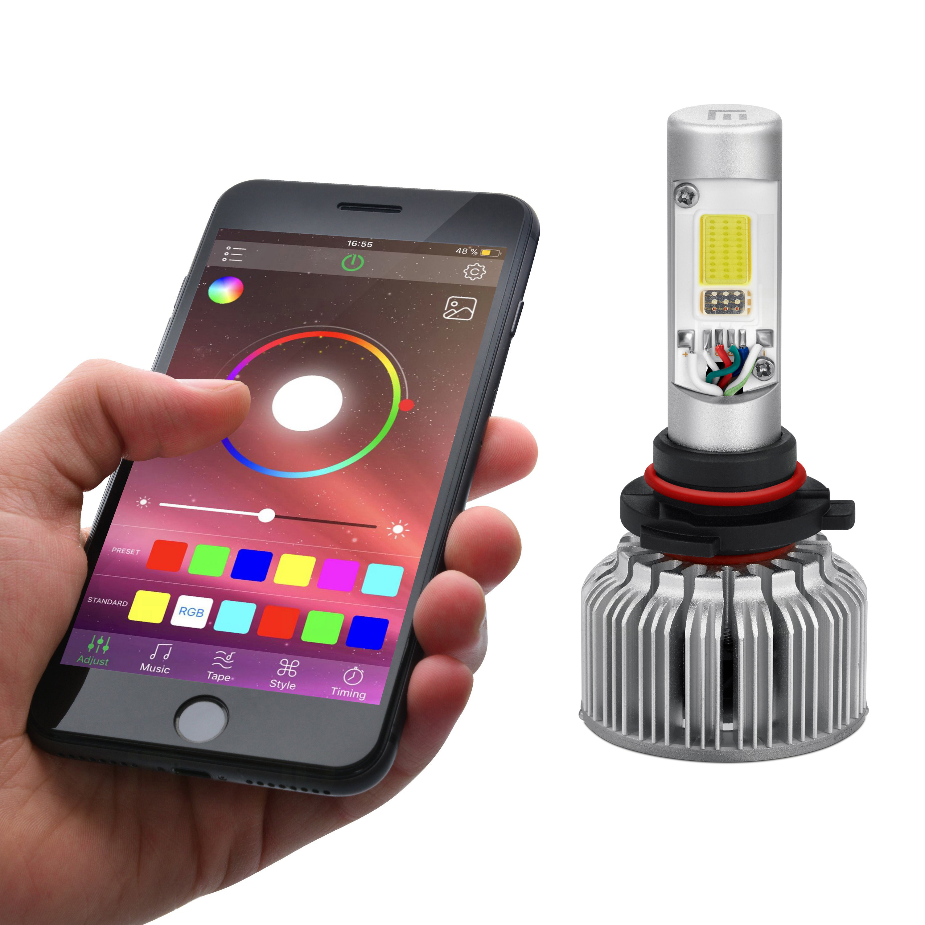

I have a 2016 Taurus SHO and am trying to do a RGB led headlight upgrade for aesthetics.
However, I have a D3S ballast and there obviously aren't any RGBs for xenon types, I figured if I can do a D3S to HB3 Conversion I can successfully install the RGB LED bulbs I want on my car.
Does anyone have any experience tips or links for how I can get this set up to work. I haven't had much luck looking on my own.
These are the type of bulbs I found for my car of CARID however they are only for HB3

This will probably be a custom setup. You will need an adapter harness to go from the D3S ballast to the HB3/9005 bulb. You could cut the wires and terminate them with the correct connector. There will be many problems though. A low grade D3S bulb generates ~3700 lumens. A high grade bulb makes ~5600 lumens. That is PER bulb. The kit you linked generates 3000 lumens (or 1500 lumens per bulb). In addition, the HB3 bulb (or 9005) is a high beam bulb. The D3S is a high/low bulb with a shutter system. In addition, the ballast connects to the back of the headlight and uses a different retention system than a HB3/9005 bulb. The easiest way to overcome this would be to use a FPIS or low model Taurus headlight that did not come with HID bulbs. These housing use a 9012 bulb and may require trimming tabs on the bulb but a lot less work than a D3S to 9005. Most are adapting a 9012 bulb into a 9005 housing so you may need to play around and reverse engineer this process. Overall, it is a LOT of work with a very big expense to lose light. I would suggest using something like a RGB halo. This may be best professionally installed if you are not comfortable with opening headlamp assemblies.

Thanks for the heads up, I would like to find a adapter harness, but as you said there are a ton of technical issue that would come with that, I would like to get some used halogen headlights from a junkyard but even scrap yards wanna sell them $500+ per headlight :(. Either way, I'll search around and see if there are some options to convert them to and RGB set up with high lumen and H/L beam function.
