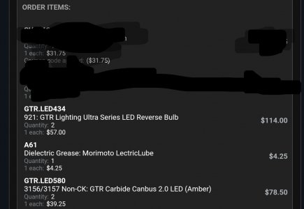

Mine is a ' 14 those turn signals on my order are awesome.
The items crossed out were returns. Perfect and quick.
