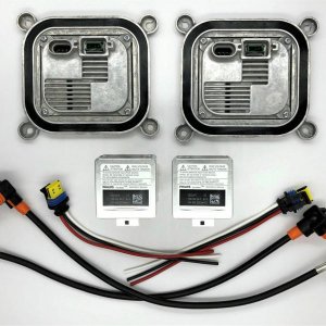

For example, this stock kit includes the power pigtail for the ballast. I'd like to replace the harness before that instead of repairing it. The electrolysis started to take out the brown (+12?) wire just before the connector too...

Not the bulb wire, the part of the harness that's inside the housing that supplies power and switch to the HID ballast.
Or is that a part of the main wiring harness and not a separate piece? It looks like the main harness plugs into the back of the housing, and the internal part is a separate harness, but it's hard to see in there.
Unfortunately that's part of the main wiring harness in the car.
