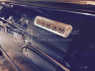

and when you get it all worked out, carefully sand off paint and polish like you do a headlight and you get this.. polished aluminum.

too much coffee, up too late...I did it on the car..which was probably harder in some ways, but I like polishing..
