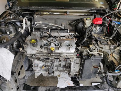

Once the motor is out that's about 40% the work done! Tentative plans for this weekend. My local car group giving me shit already saying I'm team jack stands so I gotta get her fixed up in the next couple months ha!

I mean.... She is ready to come out now! :D I mean I still gotta under the motor holding stuff of course... But everything else is finished minus a couple small time things. Waiting until I have some buddies around before I take it any further because I would like a second set of hands to make it easy.... that's what she said
