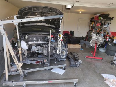

Only gotta do it once LOL always been my mantra. First time I've ever needed an engine hoist and stand in my life. They actually aren't mine either. Neighbor rolled it over from his house this morning. Good to have connections!

Look at that PTU in the back, you don't see so much of the PTU often :)
Nice work, it's scary getting started, once you got first bolt out it goes ok.

Awesome buddy! No small task for anyone no doubt! You'll be back up and running before the season ends!
Yes! Hopefully done in a month. The hard part is done and the time consuming part is now!
I was joking with my neighbor that the ptu fluid exchange is going to be very easy!

One bolt decided to strip out on one of the cams just gotta get one of those serrated bolt remover things then should be able to get her completely disassembled. Firewall head is off, water pump and timing components all off also. Just that one bolt holding me up lol

There's always one, man, there's ALWAYS one....

Got her out after grinding it down with 8mm, then 5/16 then getting ****** and hammering in the 7mm..
Motor is completely disassembled now and the culprit has been found!
