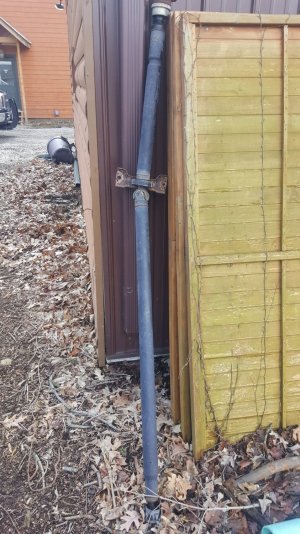

Going to take off the driveshaft today and take it to my local guru to be turned into a one piece and hoping he can machine down the crank pulley also. So lots going on but mostly waiting!

Be prepared for lots of vibrations with a one piece DS.
From others I've spoken with, it's not enjoyable. At all.
More thinking of it as a safety considering the car has seen over 160 multiple times. I'd hate for a driveshaft failure. Gotta sacrifice some things in the name of performance! Plus maybe it'll weigh less :nut:
Can you elaborate on this? Is this specifically for our platform that others had issues with? If the driveshaft is balanced correctly, I can't imagine it being any worse than stock.
Never seen a failure honestly just know I'm pushing the limits of anything stock
Actually, a fellow who pushed his into the 170+ range in Germany said his DS went kaput. Was planning on having a one-piece CF one made and that's the last I recall hearing from him.
Edit: https://shoforum.com/index.php?threads/drive-shaft-catistrophic-failure.134806/#post-1469301

I remember that guy from Germany. His failed because of a seized carrier bearing, correct?

Besides that person (in Germany), there was one other here in the States that had his fail.
Those are the only two I can think of.
Problem with ours, is the sheer length of it.
From what I understand, the length alone is what was the primary, contributing cause to the vibrations of a single DS.9c3597f73093b5691704ab225ca9891b
People don't understand how long our cars are until you work under it lol. The amount of exhaust pipe to make a true dual is around 30'. I'll see what his recommendations would be on it for sure. He's been doing driveshafts for a couple more decades than I've been alive and sounds like he does it as a hobby now a days more so than a source of income lol. One of those good ol boys.
