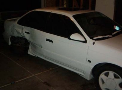

Ok, as most of you may or may not know, I got in a wreck last week. I dont get any insurance money or anything so Im on my own with my car.
My mind has been going 100mph lately, so I need to hear some thoughts and opinions regarding my cars body.
I really want to fix it. I just had it painted two weeks ago and I can't part it out.......I just dont want to. :frown: Everything on the car is good except where it got hit.
The rear passenger door and rear passenger fender is where it got hit (right where they meet is where it got hit)
Here are some pictures of the damage my car sustained:

This is an inside view of the rear passenger strut tower in the trunk.
Here is a view of the inside of the passenger door, you can see where it is crinkled.
Here is a few pictures that kind of raised my hope. This is a 91' getting a rear fender replaced. It looks like the old fender was cut off a donor car and welded in place on the damaged car.
Some of the welds:
Heres another plus.....I happen to have an 89' at home with the required panel and door.
Thoughts? I really need some input.
How much do you think a shop would charge considering I cut the panel and remove the door off the donor car. Already stripped the backseat and trunk and maybe even a few more things like remove the rear bumper etc, so they just do the hard work and not the easy time consuming stuff?
Or should I attempt it myself? I took some welding classes and my step-dad can do some okay welding.
Please give me input, I have been losing sleep thinking about this.
As always, thank you.

I think that could be fixed, Im sure worse has been fixed before. I really hoped that you would get it fixed and not part it. I remember the week before seeing the pics of your car after it was painted and was very impressed by the way it turned out. Did you get the suspension work done yet?

If it were up to the insurance company on whether to repair it or not they would probably total it, but they seem to total shos for everything now. I was thinking of all the time constraints and work involved finding a donor car and what not but it sounds like youve got that covered! I think it can be done, the crinkling under the seat could he hammered out( doesnt have to be perfect cosmetically if you cant see it right! As long as your frame and suspension and all was able to be brought back into specs i think you could do this. I thought ur car looked great fresh out of maaco so i say cut and swap the parts out and get it re sprayed on that side and your car will be back to its pretty appeal. As far as repairing whats there thats pretty far out of reach, but if you can cut it out and replace it with ur parts car..... sounds great to me :thumb:

The hard part is where the door closes, there was alot of metal there and it got scrunched up. I dont know if that would be part of the fender that gets cutt off the other car. Im just worried about the door shutting correctly should I attempt this.

Coming from someone that does body work on my personal cars...yes it is fixable. I have seen lots worse.

I'm definitely not an expert on body or metalwork, but I think if the main suspension and door fitments are restorable the rest is cosmetic.
If you find another SHO in the junkyard (or even just another Taurus, that shouldn't be hard), take some measurements that will allow you to determine whether the strut rod attachment point or torque box got tweaked. Also measure around the strut towers to see how badly yours is damaged.
Fitting the door and jambs would be the other challenge.
The rest is cosmetic as far as I can tell and can be pounded back or replaced with sheetmetal from your donor car. Since you have the appropriate donor car available this sound like a real possibility.
It's certainly going to be a fair amount of work, but it all seems doable to me. It would be good to hear from folks who've done this sort of thing, though.

Your rear fender and rear door can be replaced, just like the pictures of the other car. However, keep in mind that the car is unit body construction. You may be able to find out if the body is knocked out of alignment when you go for a four wheel alignment. Otherwise, the only way to tell is to have the body mounted on a "dedicated bench". This can be expensive.
Talk to a professional body shop that has a dedicated bench, and/or go for an estimate on the repairs, and see if they mention aligning the body. You do not want to be one of those cars you see coming down the road sideways! rangerj

FIX IT, FIX IT, FIX IT! Keep the SHO's on the road at all costs!
