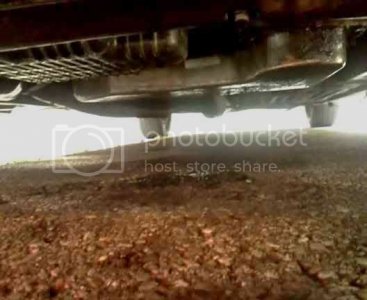

Ok guys just go finished making a video of where it is leaking. Sorry for the bad camera work but my phone isnt the greatest to hold onto with a couple fingers
Th OILPANGASKET

It's probably burning some too. A quart every 300 miles is A LOT to leak.
Your going to have to just start somewhere. I'd personally start with the oil pan and the oil level sensor. Those are the easiest. Change them and go from there.
The rear main means pulling the transmission, so obviously i'm sure your not rushing to do that.
With the oil pan eliminated it will be much easier to tell what else is leaking.

Yes i think i will do oil level sensor. Then oil pan if that doesnt fix it. I know rear main is a pain so i am hoping its something different. The only oil i see is on the driver side cam sensor one. thats the only one that is leaking.
