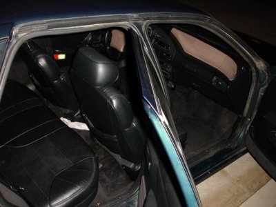

interior paints
CerberuS
300 HP N/A SHO
Apr 19, 2006
1,730
Granby, QC, Canada
Any of you used some interior paint? , i want to paint the dash black (to fit the rest) , whats the brands out there , any pics would be awesome , and/or some tips on how-to.

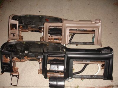

I changed my dash to black with the.. "swap" method. :rofl:
Dsc13730
Dsc13766
Dsc13764
Dsc13780
pics from when the swap was done a year ago, it has a black console now..
I really likey your airbags and inserts in the fourth pic ;) . Swapping is better then painting any day of the year!

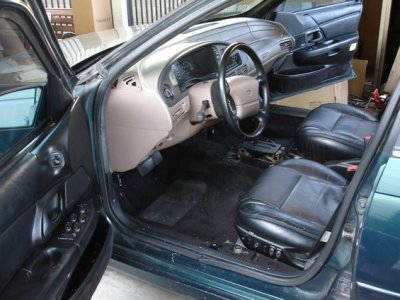

I've bought beige interior paint from the Ford dealer. Maybe black is available, its worth checking out. The paint is a lacquer and has really good adhesion quality. I painted the bolsters of the driver seat in my ATX and they turned out great! You can't even tell they were all crappy looking. I'll get some pics on Sunday and post them for you to see. Cheers.

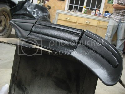

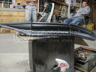

If you can wait till monday, I can show you pics of a gen II center console that I painted black for my gen I. I used SEM prep spray and then Landau black, it gives a nice oem finish that is fairly scratch resistant. I have used SEM many times in my line of work and never had any complaints!
