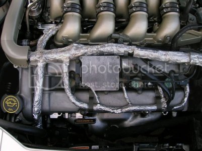

I used some hi temp aluminum tape. Basically aluminum foil with an adhesive backing. Works good, I need to re-wrap some parts up front.

I don't think I like the aluminum thingy. If someone who isn't that sharp wraps that around already damaged insulation wires, couldn't that become a nice ground?

Yikes! Well I guess at least the aliens won't be able to communicate with your car with all that aluminum shielding! :nut:
Go to your local speed shop and get a foot of 3/4" to 1' fire sleeve and slit it lengthwise. Should cost about $18 or so.
