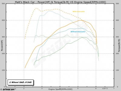

Intercooler = Gearhead. Dunno if they have in stock ready to ship, but if they do, turnaround has been good.
Methanol octane rating is 115, IIRC. Sunoco might disagree tho
https://www.sunocoracefuels.com/tech-article/alcohol-and-octane
It can help cool the charge tho in the absence of a better intercooler, even if you do not use it for octane. If you install the GH intercooler, that point becomes moot.
https://www.ghtuning.com/product/2010-2018-sho-flex-performance-intercooler/
SHO Intercooler Only
If I had to do any mods, this would be the one mod.
It even has a built in drain plug for maintenance!

Do I need to contact LMS to get a new tune for having the improved intercooler, or do you think having a 100 Octane tune will have enough timing to take advantage of it?
9,047
4,393
You can always optimize the tune further, but should not really be any pressing need, as the MAP sensors and the PCM will deal with the resulting changes. Unlike downpipes where airflow isn't monitored, o2 content is, thus requiring a tune update to be at its best.
That said, if LME will tune for this intercooler, why not! You can always revert back to the 100 octane tune pre IC if you dont feel comfy with the postIC version.
