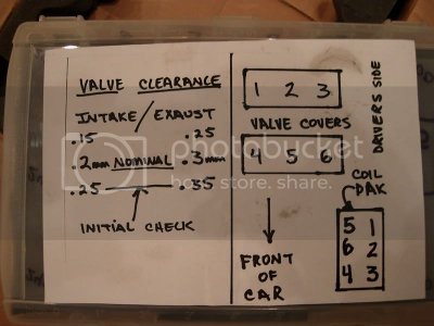

ok i was an idiot and when i was changing the spark plugs and wires and just took all of the wires out so i dont know which wires go where now. does anyone know the order in which they go? thanks.
