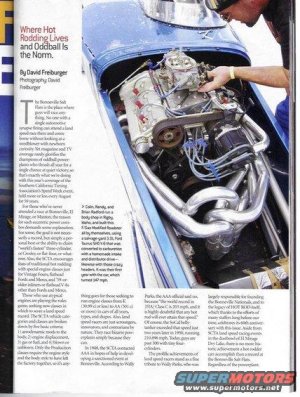

This is a good point. If you're going all out for a track car, and you really really don't want to mess with all the wiring and stuff, carb it. There's a salt flats speedster with a carbed SHO engine, makes a lot more power than stock.
You lose a lot of drivability, there's a reason cars went to EFI and, but it's doable for a track car.
Carb sho engine

wow... a distributor driven off the cam gear... that's f***ing brilliant! That's even easier than an MSD system.
But yeah, more wiring = more shit that can break. Carburetors are both very hardy and easy to fix (quickly). For an all out race motor, i would go with carburetors. Maybe you can go with triple Holley four-barrels! Wouldn't that be a hoot! (or maybe just one of these)

I would have liked to see the cam position sensor location used for the distributor, but the cam gear setup works too.
