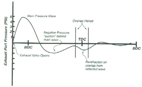

You didn't mention long ago that you had modified factory emissions control devices on your vehicle.
Tampering with the exhaust changes the resonant frequency, port velocities and timing, gas scavenging, backpressure vs vacuum during valve overlap, etc, which alters the exhaust gasses left in the cylinder vs intake charge at different RPM.
Y4Ys1i7
All those fancy pipes on the top of the engine work in conjunction with the pipes on the other side of the combustion chamber, and a computer, that knows how it is supposed to behave, injecting a particular amount of fuel and measuring the resulting stochiometry needed for catalyst activation.
