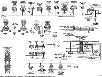

1 - power from 15A fuse #5 under the dash, +12V key-on power that heats the sensor and provides reference voltage (Pink/Orange); (you would notice a fuse out, since this also runs VAPS, part of EATC, multi-function switch turn signals, defrost button control.)
2 - ground - On the three-wire sensor, O2 sensor ground is on the harness under the center of the intake manifold (black); check for continuity between harness plug and battery;
3 - continuity of "HO2S" harness wires from o2 sensors back to ECU connector. Red/black at ECU pin 29, and dark blue/light green at pin 43.
See the harness connector diagram pinouts below for ground, "ign run" 12+, and sensor pins.

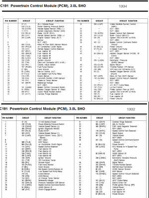

In 1992 though, we have F2DZ-12A650-AA (X2J) (1992-1995) - and F2DZ-12A650-BA (W2Z) with California emissions. With EGR delete, the 1994 or one without California should be your choice to manage the engine.
I'll let you have a look for differences in the PCM pins besides EGR.
PSMGdm6
I think the descriptions of a few pins got mixed up creating the 1992 documentation. It is unlikely that these functions below switched position. Rather, somebody got confused because IAC (intake air control) was renamed IMRC, and ISC (idle speed control) was renamed IAC.
1992: wiring diagram : Idle air control - circuit 965 LG/P - Pin 32
1994 : wiring diagram : Intake manifold runner control (secondaries) - Circuit 965 LG/P - Pin 32
1992: wiring diagram : Idle air bypass valve - circuit 68 O/BK - Pin 21
1994 : wiring diagram : Idle air control valve - circuit 68 O/BK - Pin 21
Also 1994 has one change I know of - the AC refrigerant containment switch - it seems the ECU is only informed about that on the ATX, though.
PSMGdm6

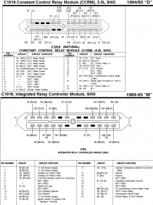

You must use the correct relay module shipped with your car for your year. The wiring harness circuits and pinout is quite different.
D for 1994-1995 and M for 1989-1993.
You can see the significant differences, note the circuit numbers (1994-95 identical diagrams; 92 depicted below while 93 uses some different terms)
W7Io1Lw
The description for 94/95 pin 1 and pin 2 is wrong; circuit 181 is still cooling fan low speed power (but on different pins).
