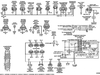

The O2 sensor light going on and off on a pretty regular interval is how a bad sensor behaves, failure to detect switching. Since we've been switching sensors here and haven't rectified the problem, one might instead look at what else could cause such a fault.
Having other engine management missing and setting codes and illuminating the CEL will aggravate our diagnosis. We wish the ECU was aware of your non-EGR. When the EGR is commanded opened and closed, the computer can discover something is up, because it can sense even the non-response in the fuel mixture and RPMs just from having the small intake passage port plugged up. Expecting EGR could upset the learned fuel trim mapping.
Since it continues to have O2 sensor issues (rather than perhaps actually "running lean") I would ensure the harness circuits at the connector to both O2 sensors are working with a multimeter before going to more drastic measures:
1 - power from 15A fuse #5 under the dash, +12V key-on power that heats the sensor and provides reference voltage (Pink/Orange); (you would notice a fuse out, since this also runs VAPS, part of EATC, multi-function switch turn signals, defrost button control.)
2 - ground - On the three-wire sensor, O2 sensor ground is on the harness under the center of the intake manifold (black); check for continuity between harness plug and battery;
3 - continuity of "HO2S" harness wires from o2 sensors back to ECU connector. Red/black at ECU pin 29, and dark blue/light green at pin 43.
See the harness connector diagram pinouts below for ground, "ign run" 12+, and sensor pins.

Continuity between harness plug and battery...where is harness plug located?
I'm talking about the connector that the O2 sensor plugs into, both in front of and behind the middle. You're unplugging the sensor, and testing with a multimeter in "ohms" that each of the pins and their wires has an unbroken connection back to their respective 1) 12v power, 2) ground, 3) ECU

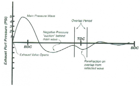

You didn't mention long ago that you had modified factory emissions control devices on your vehicle.
Tampering with the exhaust changes the resonant frequency, port velocities and timing, gas scavenging, backpressure vs vacuum during valve overlap, etc, which alters the exhaust gasses left in the cylinder vs intake charge at different RPM.
Y4Ys1i7
All those fancy pipes on the top of the engine work in conjunction with the pipes on the other side of the combustion chamber, and a computer, that knows how it is supposed to behave, injecting a particular amount of fuel and measuring the resulting stochiometry needed for catalyst activation.

The ghost problem has been solved!!! Finally after months of frustration and tons of work. The problem turned out to be a corroded ground wire for the o2s in the engine valley. While testing for continuity on all the O2 wires, wiggle test made me discover the problem. So happy...until the next issue arises lol.
