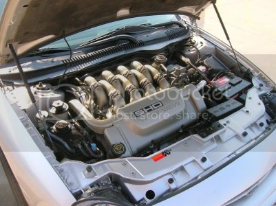

Here we go:

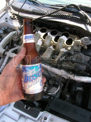

Teardown
DSCN0843
ARGH

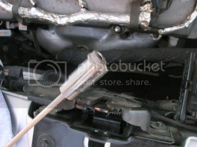

Handy little tool, magnet and a led flashlight
DSCN0849

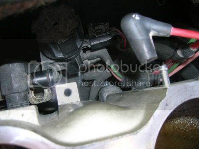

Motivation
DSCN0851

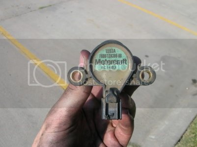

The bad coil is third from the left

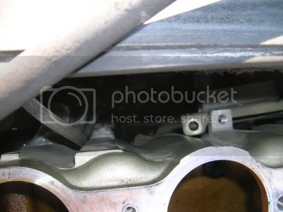

It runs! Support brackets missing.

Cracked boot, possible reason for failure?

From my experience, the white-topped Motorcraft coils fail the most.
