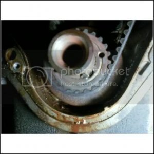

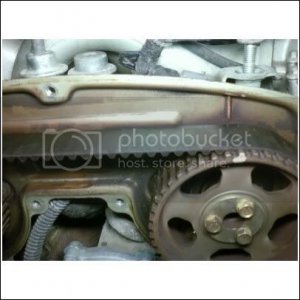

Just pulled the timing belt cover off and i noticed a bronze oily coating all over the cover. This greasy coating also had what looked like metal flakes in it.

that looks normal to me.
the only way to tell for sure is to take off the crank pully and give the key a look-see.

Just pulled the crank pulley out... by hand. :oogle:
Looks like the key stock was been bent/molded and then broken in half where the keystock goes through the timing sproket on the crank.
The keyway on the pulley looks fine. Just seems like the actual keystock has been warped and bent.
Isnt that keystock a Ford only item? Discontinued? Other options?
