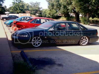

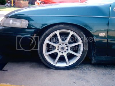

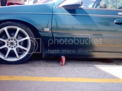

My Gen II sits about half a pop can off the ground...ill try to see if i have the pictures or not sitting around and i have no problems, actually feels/rides like a stock sho

wow... and you still have your front/rear bumper and side skirts???? wow..... :laugh_ti:
that looks really good, but i dont think i would want it here in texas... esspecially when we go on our runs in the hill country.... but if i has always in the city, i would like to have my sho that low.... :thumb:
my front bumper is 6inches off the ground... just fyi.
