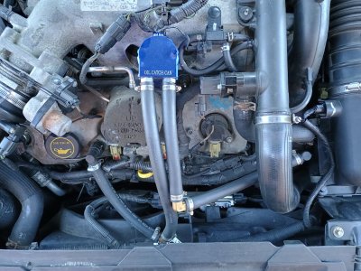

I do have the HV Melling pump. I was sucking oil with the CSS that came with the UPR setup. I plumbed in a cheap amazon catch can to take car of my issue. I will keep the oil weight change in mind, thanks for the feedback.
