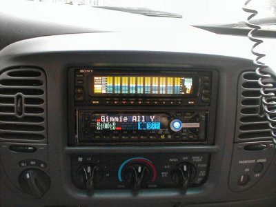

I have a question for the audio gurus here, hope I can get some insight.
This is my current setup:
I have a sony deck which has two pairs of RCA pre-outs, one pair for the front and one pair for the rear, it doesn't have a Sub pre-out.
What I did was connect the RCA cables to the Rear pre-outs in the deck to an aftermarket 2 channel AMP (Soundstream) then bridge it and connect the stock subwoofer to it.
What I'd like to do:
In all the stuff that I have for the car I found the JBL AMP for the 4 speakers, I already looked into the diagrams, but I still have a question.
Since my Sony deck only has 2 pairs of pre-outs for Front and Rear and it doesnt have a pair for a subwoofer, can I make a split (connect another RCA cable) on the Rear
pre-out and still have the current setup for the subwoofer and also feed the JBL AMP for the rear speakers out of the same Rear pre-out from the deck?
I hope I made this clear enough, if not I'd see on doing a diagram.
*Edit: I'm not using much of the original car harness. The rear speakers have been rewired
