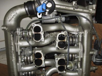

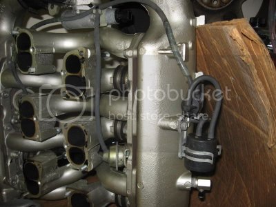

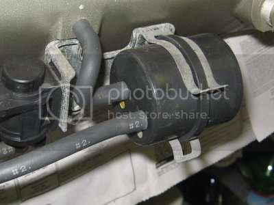

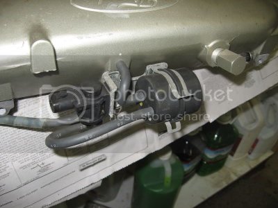

This should show you what you need to know. Notice that one dot on the cannister is brilliant white and has the letter A embossed next to the port. It can also be identified by tiny lettering etched into the side of the can near the port. This port goes to the solenoid valve, bottom port. The other dot is yellow-ish, and has the letter B next to it. That goes to the intake manifold port.
SecondariesIMRCVacuum4 2
SecondariesIMRCVacuum3
SecondariesIMRCVacuum2
SecondariesIMRCVacuum1
Keywords to aid future searches looking for this information: IMRC secondary secondaries vacuum cannister Intake manifold runner control
