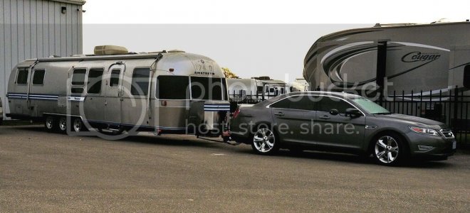

I think I've shared this photo before, from a RV magazine a few years ago. Seems I remember the article said this was taken in Canada.
IMG 20151117 210843
Sent from my XT1094 using Tapatalk

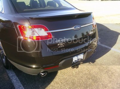

I have a Hidden Hitch on my 2011 SHO that I bought from eTrailer. It didn't require any modifications to the exhaust and fits fit. I have only used it with a bike rack. It was an easy installation - I did it by myself from a creeper with the car on jack stands. No drilling was required. Here's the only photo I currently have uploaded to a sharing site.
Hitch
