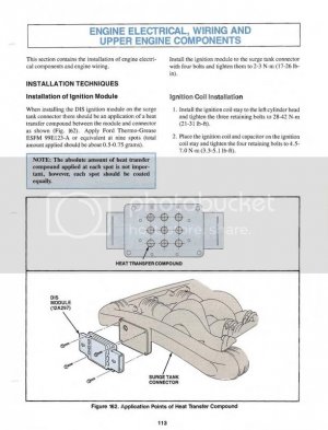

That's not the service manual.
"Heat transfer compound" is what Ford called it then - it's now referred to as Brake Caliper Grease & Dielectric Compound (Motorcraft XG-3A). Previously it was referred to as "Ford ESFM-99E123-A Thermo-Grease", and then "Silicone Dielectric Compound WA-10; ESE-M1C171-A (Ford p/n D7AZ-19A331-A).
