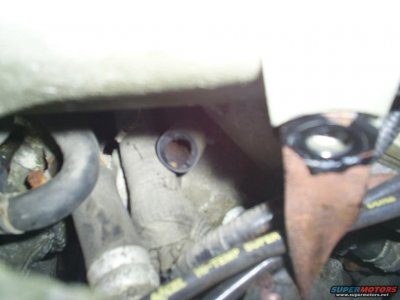

I need help asap please guys. I was changing my valve covers and spark plug seals, and I was putting the intake back on when I broke this hose. Not sure where it goes, I thought maybe it is the PCV hose but I doubt it. Is this a hose that I can get a general automotive store, or dealer only part? The hose is located under the intake, but also is in between the intake and TB. Thanks, I need to get this fixed by tomorrow. The hose is obviously the broken piece in the middle of the screen:

It sounds like the hose that runs from the valley pan on top of the block, to the bottom of the throttle body. I believe a piece of bulk hose will work. I broke mine before too. They just get real brittle from all the heat and oil vapers.
